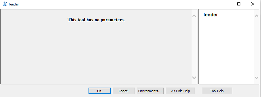

Right now when i start my python script file i get a popup window that says "This tool has no parameters". I then click ok and my script will then run. Is there a way to disable this popup window so that my program will run right away?

I think the answer to your question is, there is no simple way (I can't remember if there is even a difficult way) to disable the popup you are seeing.  The popup you are seeing is a fundamental part of the architecture of script tools.  Even when there are no parameters for a script tool, the popup is there to provide a user with a description of the tool and help information to help the user with the tool.

Did you attach the script to a tool in toolbox?
Where are you running the script? (separate python IDE?)
RickHawkins
Dan, I did attach the script in a toolbox
DanPatterson_Retired
MVP Emeritus
Then the popup appears, if memory serves.
There is probably no point in attaching it to a toolbox, unless you want to make the parameters for the tool defined/exposed.
You can set defaults for the parameters to at least give users a view of what the parameters are before they run it.
If this is for a scheduled task, then the script doesn't need to be attached at all
