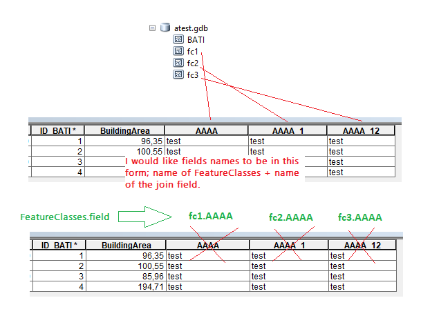

Using ArcPy, how do I add the name of FeatureClasses to the names of the joined fields?
This is my code which I think helps explain what I am looking for.
thank you for your help

Thank you for your feedback!, I've checked the documentation. I chose JoinField because I can specify the fields to join but AddJoin it join all the fields and that for a dozen featureClass it will give me a hundred fields in the table to delete after and leave only the desired fields.
I modified my code by inserting (arcpy.env.qualifiedFieldNames = True) and arcpy.MakeFeatureLayer_management in my code. but the output field name still does not include the featureClasses names.
