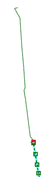

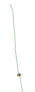

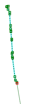

Take the northern part of your polyline (I exploded it into single parts):
This is part 5:
This is part 6:
This is part 7:
The red vertices are the ends of the line parts.

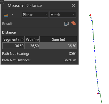

In your code, you loop through the line parts and append the points from start to end of the line part. That means that you suddenly have a virtual line from the end of part 6 to the start of part 7:
This accounts for 36.5 meters of your error. Add in the other virtual lines you introduced and you got your difference.
