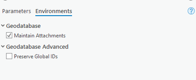

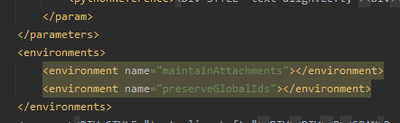

For anyone still trying to figure this out, you can control what Environment settings appear on the Environments tab in a Python Toolbox by editing the tool's xml metadata file adjacent to your pyt.

        @TedHoward2 I am a little confused. In my case ,the XML file doesn't existed until I added the pyt file into my ArcGIS Pro (Catalog-Toolboxes-Add Toolbox). So how can this be preconfigured before I distribute the pyt file to my end user?
TedHoward2
If the xml file exists in the same folder as the pyt, then it will be used when the toolbox is added to an ArcGIS Pro project. You must distribute both the pyt and any relevant xml files if you want the metadata help to be included for the end user.
