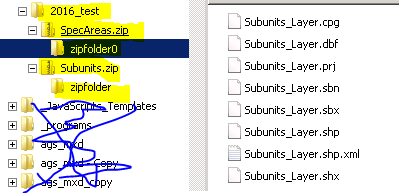

Although it is meant to be used as a GP tool, I have been able to get my script to work, but the output it not AGOL friendly.  That is, it adds another layer/folder in the zip structure...  e.g.  myfile.zip\zipfolder#\myshapefile.*   This "zipfolder#" seems to be hard coded into the ExtractData_server.  I know there are other scripts to open/read/write to a .zip, but this actually works nice, except for that added folder.
Is there a simple python way to reoganize a zip.  If it requires an open-cursor-write-close like the samples I've seen, I may just go that route and skip the ExtractData command, but other than that extra layer, this custom version works great for my needs  (just one shapefile to a zip)
I've testing in 10.2.2 and 10.3.1, Catalog and map (python command window, not as a tool yet)
outputted format:
would like the "zipfolder#" level removed.

The zipfile module works well.  You can zip the files in a folder like so:
import zipfile
outputSHPzip = arcpy.env.scratchFolder + "\\shpzip.zip"
shpZip = zipfile.ZipFile(outputSHPzip, "w")
for root, dirs, files in os.walk(ShapefileFolder):
   for f in files:
      shpZip.write(os.path.join(root, f), f)
shpZip.close()
