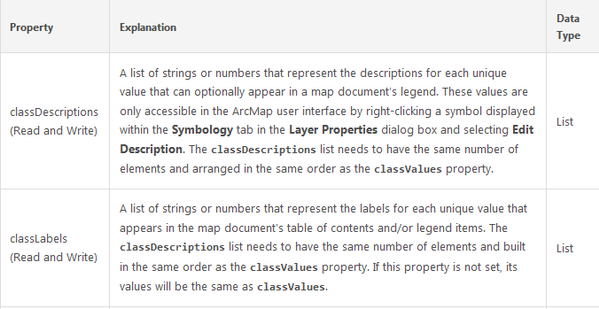

Hi Ian, Here a year later. Can I edit labels so that I allocate a field in a layer manually or through arcpy? It is denoted as read/write but cant edit it other than through TOC.

I wonder if you can use UniqueValuesSymbology—Help | ArcGIS for Desktop  but "trick" the unique value to only have one.  then use one of these properties?
I didn't see a set of properties for no-unique-values otherwise.

WilliamKalande
Thanks Joshua
I applied the code, it changes the expression label field as below and that is fine
What I need though is the TOC to maintain the value field assigned under symbology properties but allow me to use another field in the layer as a label or to copy the corresponding values into TOC. What I mean I want for instance the values below in the OpCodeBoundaries. The value field set in symbology is say field A. I want to maintain that but change the display in the TOC window to display values in Field B. Effectively, that will change the display in the legend
