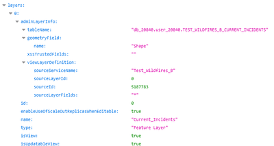

Find the 'layers' property array, this will contain the detailed json for each layer in the service. For each layer, locate the 'adminLayerInfo' property to see what table the layer points to. The property 'tableName' should match on both the Service layers and View layers. The layers in the View will also contain an addition set of properties called 'viewLayerDefinition', which points to the name of the service it depends on (the origin of the view).
The View 'layers' should look similar to this:

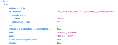

And the Service 'layers' should look similar to this:
If the table names match, then the view was updated correctly.
