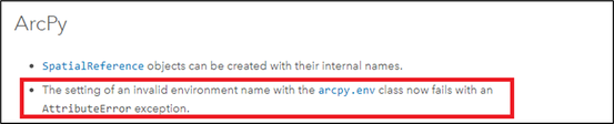

With that, I think I may have stumbled upon something. Looking at the What's new in ArcGIS Pro 2.9 list, it seems this type of error is a new implementation:

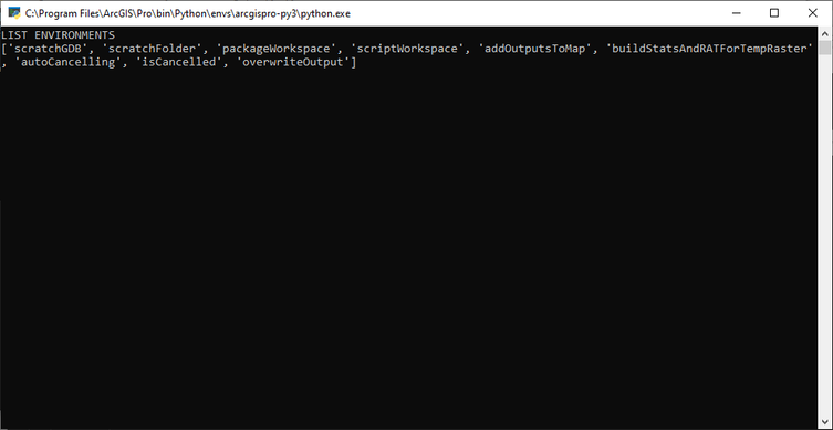

So, I tested this out by printing a arcpy.ListEnvironments() during the multiprocessor portion for both the v2.7.3 and v2.9.0 machines, and got the same result, shown here:
It seems that most of the environment settings are missing from the multiprocessing environment. Why might that be? This suggests that they were never being set at all on the v2.7.3 machine, as that version wasn't capable of throwing errors for invalid environment names.

Did you ever find a solution to this? When I print the current environment attributes, I get a pretty small subset *when running a static sub-class within a Script in an ArcPro Toolbox.*
['scratchGDB', 'scratchFolder', 'packageWorkspace', 'scriptWorkspace', 'addOutputsToMap', 'buildStatsAndRATForTempRaster', 'autoCancelling', 'isCancelled', 'overwriteOutput']
I am not sure what limits the environments available as a result of it being called within a Toolbox, as opposed to being called from a 'regular' Python script.
