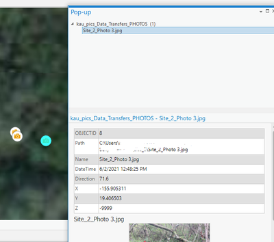

Not sure entirely what you want, but to expand on my earlier post:
That tool will give you this sort of output:
Add a field for the Yaw, then update it for each record based on your dictionary.
