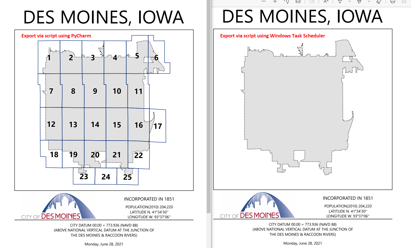

I wrote a script that exports a title page and a map series. When I run the script manually in PyCharm, the title page exports correctly.
When I set up the script to run in windows task scheduler, the title page exports without the map frame (see image below)
Has anyone come across this and is there a way to fix it?

AliciaShyu
The issue was that the grid was in a database outside of the Pro project. Once the grid was moved to Pro project, the script ran correctly in task scheduler.
