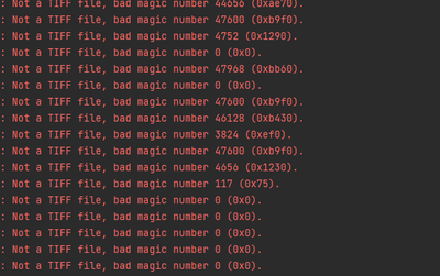

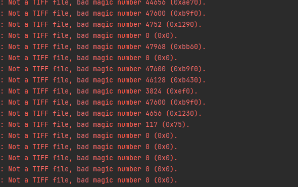

I am having a problem with the ExportReportToPdf tool. When i export a report from ArcGis Pro it includes the attachment and company logo (PNG). However when i export via Python its missing the company logo and throws the following error:
I tried using a TIFF instead of the PNG, but the same kind of error is thrown.
I access the report from the exported report file (rptx file). This file seems to be ok.
Does anybody know why it is not exporting the full report with the PNG?
