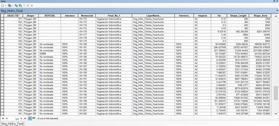

these are the feature classes in the gdb:
and this a part of table's Veg_Hidro_Final

Runtime error  Traceback (most recent call last):   File "<string>", line 15, in <module>   File "c:\program files (x86)\arcgis\desktop10.3\arcpy\arcpy\conversion.py", line 81, in TableToExcel     raise e ExecuteError:  Traceback (most recent call last):   File "c:\program files (x86)\arcgis\desktop10.3\ArcToolbox\Scripts\TableToExcel.py", line 222, in <module>     arcpy.GetParameter(3))   File "c:\program files (x86)\arcgis\desktop10.3\ArcToolbox\Scripts\TableToExcel.py", line 216, in table_to_excel     workbook.save(output)   File "C:\Python27\ArcGIS10.3\lib\site-packages\xlwt\Workbook.py", line 662, in save     doc.save(filename, self.get_biff_data())   File "C:\Python27\ArcGIS10.3\lib\site-packages\xlwt\CompoundDoc.py", line 261, in save     f = open(file_name_or_filelike_obj, 'w+b') IOError: [Errno 22] invalid mode ('w+b') or filename: u' C:\\Users\\LAP77\\JR\\Veg_Hidro_Final\\Excel\\Veg_Hidro_Final.xls'  Failed to execute (TableToExcel).
and when I use the script again, this is the error.
Runtime error  Traceback (most recent call last):   File "<string>", line 14, in <module>   File "c:\program files (x86)\arcgis\desktop10.3\arcpy\arcpy\management.py", line 6966, in MakeTableView     raise e ExecuteError: ERROR 000725: Table Name: Dataset tview already exists.
