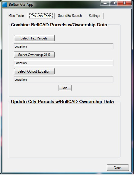

I have a program I've written in VB which will allow me to select all the files necessary for the join and run the python script. (this stores the input files to a variable in an .ini file, which the python script reads the variables with ConfigParser()
