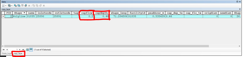

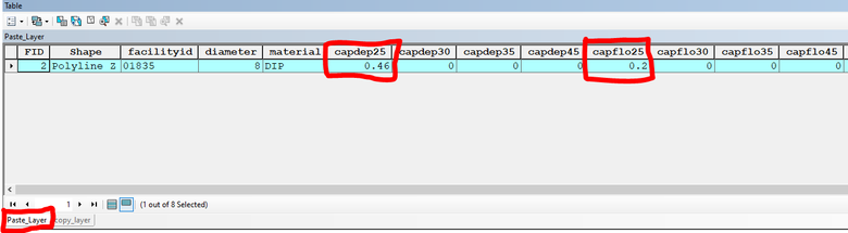

I see how that is different, but I'm not sure if that will do what I'm looking for. I need to be able to select one field in the copy_layer and paste the values of those copy_fields to just a single asset in the paste_layer that I would be selected before the script is run.
Example:
Selected field from Copy_Layer
Paste that info in the copy_layer that is selected
Is there a way to do that? I'm asking because it's possible that the the OBJECTIDs for each of these are not correlated correctly where the lowest OID from the copy_layer will match with the correct feature from the paste_layer. i.e. spatially, feature 001 from the copy layer may correlate with feature 099 from the paste layer , which would mean there a different feature with a lower OBJECTID like 040 from the paste_layer would match with with 001 from the copy layer.
