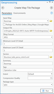

Anne-MarieDubois
I know this thread is old but I was having the same issue. My problem was solved by first creating a map tile structure file (https://pro.arcgis.com/en/pro-app/latest/tool-reference/data-management/generate-tile-cache-tiling-s...) and then using that as "service parameter" to generate my tile package.
