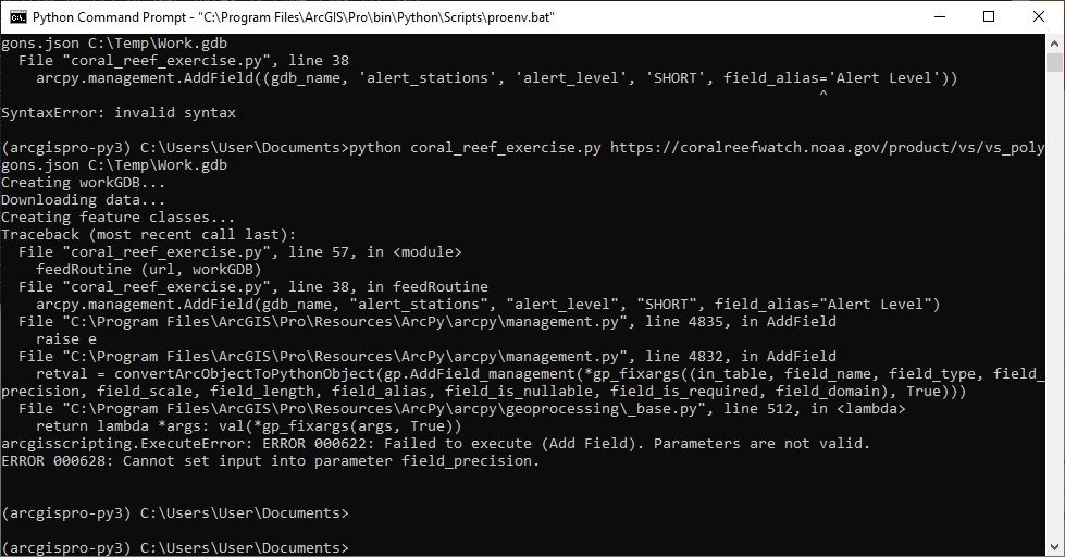

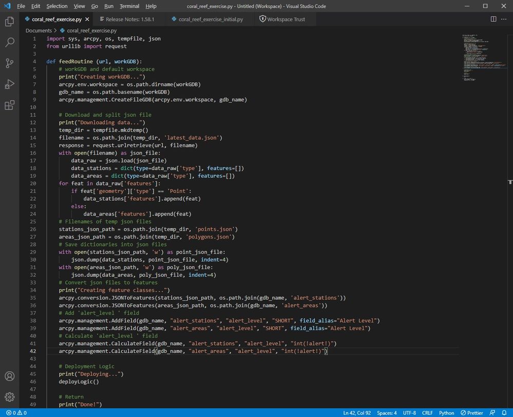

I try to follow tutorial in ESRI training (https://learn.arcgis.com/en/projects/update-real-time-data-with-python/), but have problem in converting JSON to Feature. I think that my error  in lines 38-42 in the script I made. but I don't know the details of where the error is.
Tim_McGinnes
The first parameter of both the Add Field and Calculate Field tools should be a table, but you have the first parameter as the geodatabase and the second as the table. Try something like the following:
arcpy.management.AddField(os.path.join(gdb_name, "alert_stations"), "alert_level", "SHORT", field_alias="Alert Level")
arcpy.management.AddField(os.path.join(gdb_name, "alert_areas"), ...
arcpy.management.CalculateField(os.path.join(gdb_name, "alert_stations"), "alert_level", "int(!alert!)")
arcpy.management.CalculateField(os.path.join(gdb_name, "alert_areas"), ...

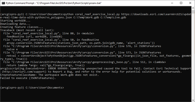

And if i continue to next step, i found this trouble. Here I attach the error and the script that was made.
I'm very happy if you can help me with this problem. Thank you
