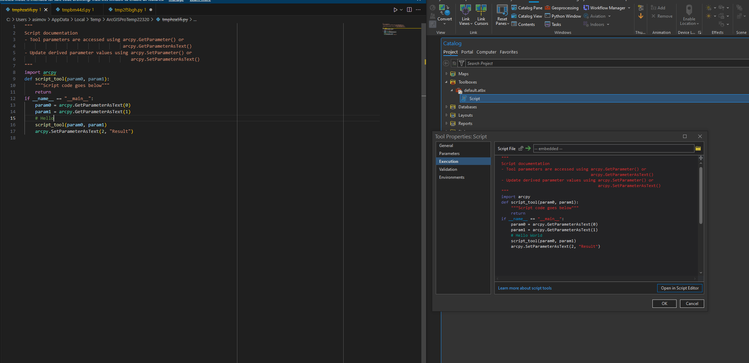

There's a screenshot of what I'm talking about. This bug happens if you close the properties window and then re-open it in Pro. The tempfile it generates is different every time and it loses context from the last time you opened the script in the external editor (see the markthrough in VS Code up top). So if you did want to develop this way, you'd need to make sure you *Never* close the properties dialog while editing your code, or the next time you open it it will delete the current file you're working on and create a new one from the last saved state.
