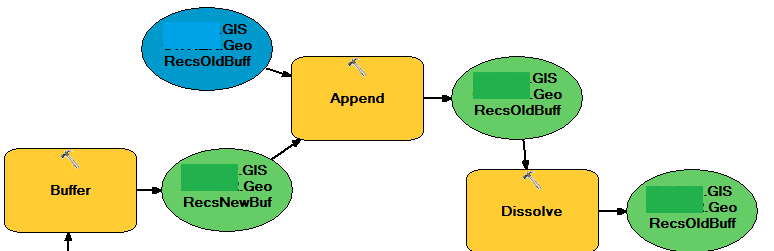

I constructed a model that at one point appends 2 layers and then dissolves the data. The append accurately appends data from both layers but the dissolve only contains data from one layer. I have this same process in 4 other models and it works for those but not this one. This process does work when I run it in modelbuilder. My python script was exported directly from the working module. I have compared the script against the working scripts and can find no difference in the procedures.
For Example (Cliff Notes Version):
LayerNew: New data that was just buffered
LayerOld: Old data buffered that needs to be updated
Append LayerNew with LayerOld. Outcome is LayerOld containing data from LayerOld and LayerNew.
Dissolve LayerOld. Outcome is only data from LayerNew.

Okay, it's just that the picture of your model shows Append flowing into Dissolve, but unless your two layer name variables are equal, that's not what your script is doing.
Also, the path in the Append tool is enclosed by double, then single quotes, which is non-standard. I'm not sure if that causes any problems, just not sure why it was interpreted that way.
