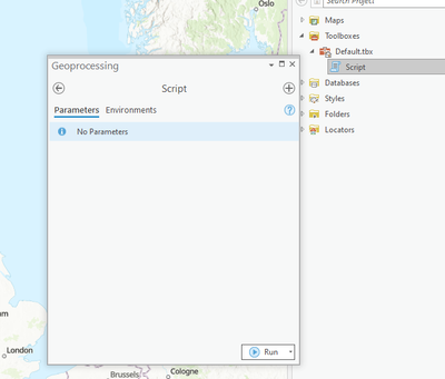

 I connected the script to a tool script but as there are no input parameters the tool runs as this:

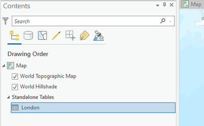

The Table is added as shown below:
Now if I use p.save() instead of p.saveACopy() then the table IS NOT saved to the project. This seems like a bug to me.
