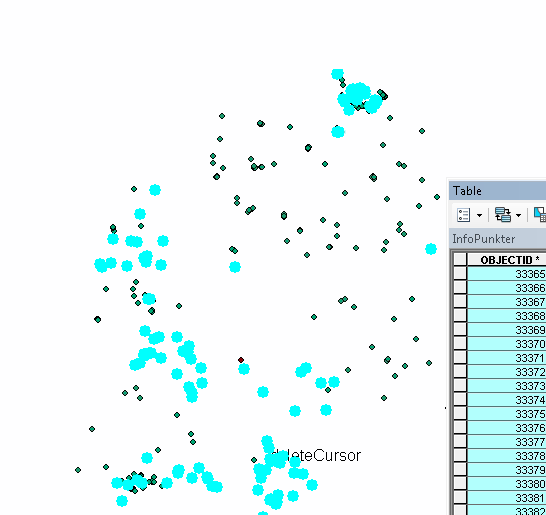

If I create an insert cursor outside a for loop all inserted rows ends up with the same shape.

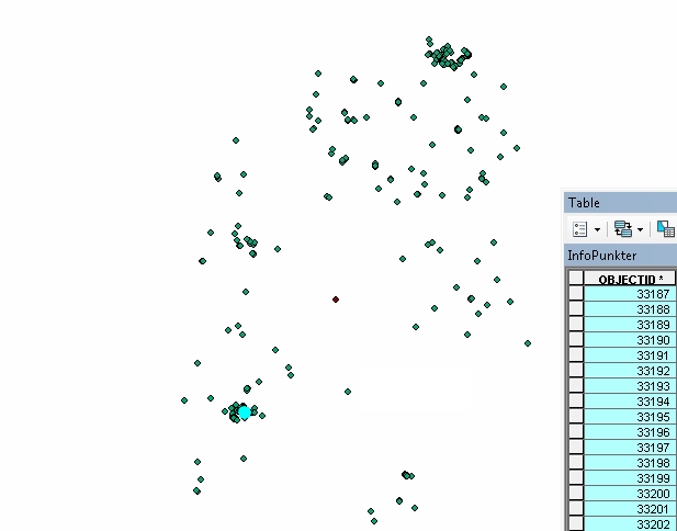

If I create the cursor inside the for loop i end up with the result that i expected

The first example the cursor is created outside the loop
 The result:
If i move the creation of the cursor inside the loop
The result:
Why am I getting diffrent results?

How many items are in nogleboksDict?  And, how are you selecting the records in your screenshots?
DanPatterson_Retired
MVP Emeritus
leonoestergaard
Joshua Bixby‌  178 items in the dictionary. Im using "select by attributes" and querying with at like on a text field
