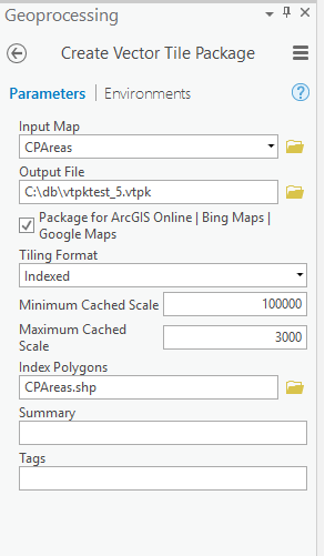

Screenshot of successful run from geoprocessing tool in ArcGIS Pro:
Code sent to Python Window from history:
arcpy.management.CreateVectorTilePackage("CPAreas", r"C:\db\vtpktest_2.vtpk", "ONLINE", None, "INDEXED", 100000, 3000, r"\\\CPAreas.shp", None, None)
