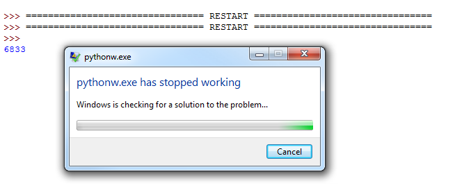

When I run it I get the following (6833 being the MEDIAN):
the dialog eventually dissapears without producing the 'Final_Test' raster.

Thanks Sephe Fox,
The paths were ok to have spaces (this was the test data, real data resides on a lengthy server path)
Changing the syntax of the tools cause python to produce an actual error rather than crashing:
     Rescale By Function() takes at most 4 arguments (currently 7 total)
the solution is to create a transformation function object to pass into the tool, works great now:
