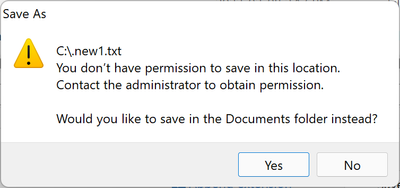

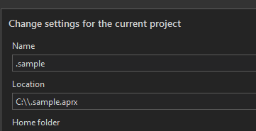

"C:/.colorado.aprx"
will fail, if that is the path since an aprx can't exist in the root directory nor begin with punctuation.

Maybe that changed in a recent version?
Seems to work just fine. Not that it's a good idea, but it seems to be "legal".
- Josh Carlson
Kendall County GIS
DanPatterson
MVP Esteemed Contributor
It will come back to haunt people at some point
works for some isn't a good idea
