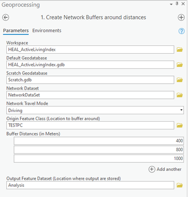

HI,
I have a script that runs perfectly fine using variables for the inputs. As soon as I turn them to parameters, I am running into a "RUN TIME ERROR" with no details. I cannot for the life of me figure out the issue. Any suggestions? The
Thanks!
Andrew

hmm, how about changing the output location to just the GDB, possibly a mix of coordinate systems? What's with C:\Users\C:\Users\ for params 3 and 5?
Although you'd expect it to be the same as the input - and as you ay the tool does work a a standalone script.
I know you have the overwriteOutput set but still try making sure there's no locks/existing data etc. as part of the testing.

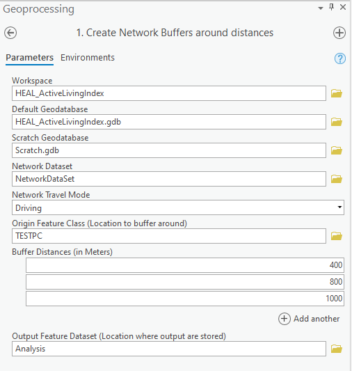

I don't see the full filepaths listed in the tool, looks more like they were dragged as layers - possibly try the full file path for GetParmeterAsText to work, or just as layers/datasets with GetParameter(n).  What data types do you have set?
I'd guess this is causing 'result' to be empty.
AndrewClark2
Thanks for the idea, but when printing out the parameters, they are all paths:
p(0): C:\Users\...\03_WorkingData\HEAL_ActiveLivingIndex
p(1): C:\Users\...\03_WorkingData\HEAL_ActiveLivingIndex\HEAL_ActiveLivingIndex.gdb
p(2): C:\Users\...\03_WorkingData\HEAL_ActiveLivingIndex\Scratch.gdb
p(3): C:\Users\C:\Users\...\03_WorkingData\HEAL_ActiveLivingIndex\HEAL_ActiveLivingIndex.gdb\RoadNetwork\NetworkDataSet
p(5): C:\UsersC:\Users\...\03_WorkingData\HEAL_ActiveLivingIndex\HEAL_ActiveLivingIndex.gdb\TESTPC
p(6): 400;800;1000
p(7): C:\Users\C:\Users\...\03_WorkingData\HEAL_ActiveLivingIndex\HEAL_ActiveLivingIndex.gdb\Analysis
I also get the following when printing out the result feature:
<arcgisscripting.ServiceAreaResult object at 0x00000223C8FBAD10>
So I believe the 'result' is not empty

AndrewClark2
You got it! Projection issue! Local dataset combined with a National dataset so mixing UTM Z17 with Lambert.... so annoying
DanPatterson
MVP Esteemed Contributor
parameter 4?
seems to be missing, or it is my eyes
