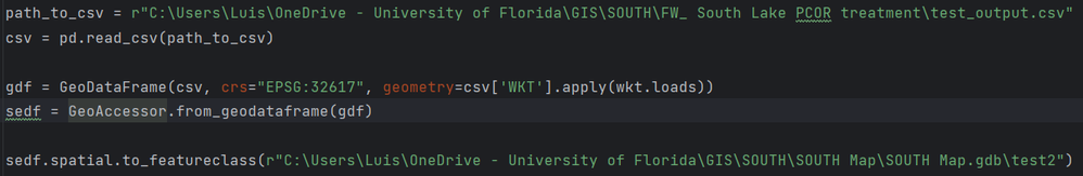

Hi Josh,
I'm trying to get this to work, but I'm getting the following error message:
AttributeError: 'str' object has no attribute 'loads'
I'm using the following code:

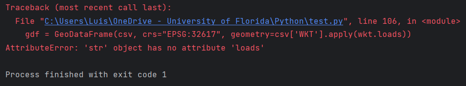

Here's a screenshot of the error:
Any help would be greatly appreciated.
by Anonymous User
Not applicable
Could be a long shot, but are you importing the GeoAssessor?
from arcgis.features import GeoAccessor, GeoSeriesAccessor
Luis
Hi Jeff, thanks for the suggestion.  There was actually an empty cell in the data that was causing a problem, but it's working now.  I appreciate it, though.
