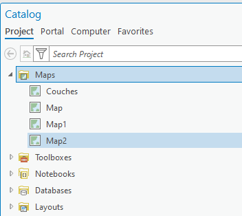

Hello @naveenbesri : the code should create a new map within the project with the MXD layers, and it will not add them to the default opened map. Checks the list of maps it should be there.

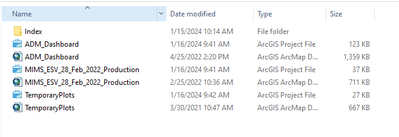

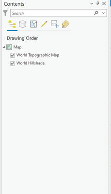

Hi, I did the same. Mxds got converted to aprx in the mentioned folder and after that when I open I saw no layers added which I have posted above. Kindly help

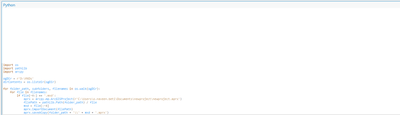

I ran the python script in python window. below is the screenshot

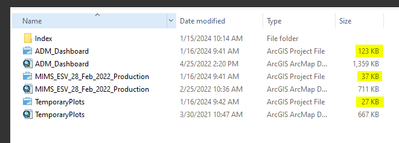

and after that aprx files have been created but no data in it.

Hello, the file size of each aprx is different so they should not be empty.
Imported MXD should be present in a "new" map within the project : you can have multiple maps in one project with arcgis pro.
