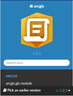

I've just updated my ArcGIS Pro to the latest version 2.7.3. (2.8 not yet available?) and my Package Manager in Pro as well as Anaconda still only give me access to arcgis package version 1.8.3. But the documentation is already at 1.8.5.
