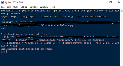

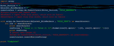

I setup two stand alone f-classes to emulate the selection results from within the model. I figured if I can get the script to function with those, then I can focus on embedding it within the model next. When I first started running the code I was getting an invalid syntax error within
arcpy.da.InsertCursor(Table2, Field_B) as cur:
I moved things around to appear like this:
, but now I'm getting a "IndexError: list index out of range" error. Any ideas?

Insert cursor uses a tuple of values for the insertRow so you will need to wrap that resString string with (), I often forget that aspect of insertcursor's and I see that I missed it in the previous example.
Looking at your image, printing the cursor will just print the object so its not really doing anything.  Try this:
      print row[0]  #should be the '1234 5678'?
      resString = 'Value 1: {} Value 2: {}'.format(row[0].split(' ')[0], row[0].split(' ')[1])
      print resString
      insertcursor.insertRow((resString))
If this doesn't work, share the print results with us so we get an idea of the data value/format.

Thanks Jeff.  I changed the code per your last suggestion.  I'm still getting the "list index out of range".  The print results only show one value, but I think it should show two.  Which from I remember might be causing the index to be out of range in "reString"

It would have failed on the insertRow eventually...  It failing on the reString tells me that the data in 'MILE_TEXT' field is not "1234 5678" and it is not splitting into two ('1234', '5678').
From the image, it printed 337.  Do you have the right cell for the cursor, or are there mixed values like 337 and 333 789?  If it is mixed like that, you will need a conditional to skip the split if there is only one.
