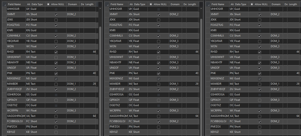

**AddFields does not allow the user to specify Scale and Precision, and I didn’t see a quick way to modify those attributes after the fact. In a FGDB, it is irrelevant, but this might matter in an enterprise environment.
Here's an example of the randomly generated fields for three of the five output methods (all three should be the same).
