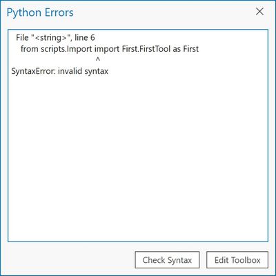

ColinLindeman
Thanks Hayden, I tried your suggestion however I still see that the toolbox is 'broken' and when checking the syntax I get an error.
Figure 1. Broken toolbox.
 Figure 2. Syntax Error.
I also tried the renaming the folders to atools and btools and trying a different way to import however I was met with no luck:
