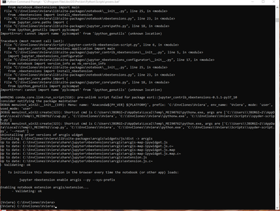

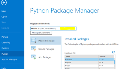

I read up more online and resorted to both cloning the Python environment and installing the modules/packages I wanted through conda via the Python Command Prompt. I can verify that the packages have installed in the cloned environment by checking back afterward in Pro and seeing them in the installed packages list.

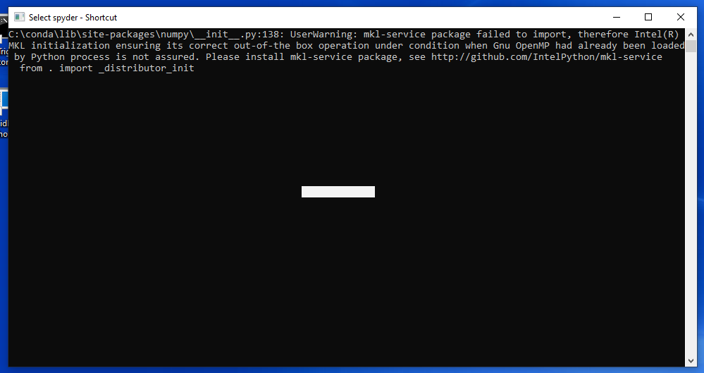

However, I can't get Spyder to launch successfully from the .exe file in the Scripts folder in the cloned directory. I get this message coming up in the Command Prompt that closes very quickly unless I click and drag inside the window. The package the error message claims is an issue is definitely also installed though. See attached screenshots.

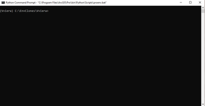

Installing Spyder: Using your Windows Start button, navigate to the ArcGIS folder and select Python Command Prompt.  It will be the new clone:
Personally I don't care for the ArcGIS Pro Package manager and prefer to use a Conda install for any custom installation of packages.  Click here for a Conda Command Cheat Sheet.
I use this command for Spyder:
Again, let it do the mojo....  You'll get a Proceed ([y]/[n]) prompt: answer y.  More bumping and grinding; be patient it may toss some warnings and other messages.  Just let it go.
Once you return to the command line, type in spyder and see what what happens.  I actually ended up with Spyder 5.0.4 because the 'channels' I go through didn't provide 5.0.5, but that's no big deal.  You can always just update when you Spyder fires up.
