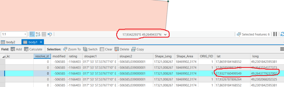

Hello,
I don't understand why if I use CalculateGeometryAttributes_management in metres it give me same values as X,Y coordinate but if I want decimal degrees value, it give me different values (picture).
Can anyone help me please?
Thanks
arcpy.CalculateGeometryAttributes_management("C:\\Users\\aneta.ryglova\\Desktop\\layout pdf\\body1.shp", [["lat", "POINT_X"], ["long", "POINT_Y"]], "", "", "", "DD")
MehdiPira1
Hi Aneta Ryglová‌,
I reckon your shapefile feature class is projected.
If it’s projected, use Project tool in the toolboxes to convert your shapefiles’ spatial reference to a geographic coordinate system before using CalculateGeometryAttributes.
