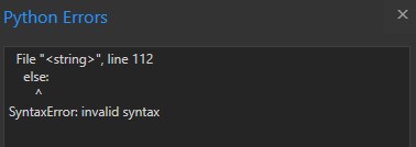

Here's the error:

Apologies for the lack of clarity. Line 112 is line 12 in my pasted code.
DonMorrison1
Ah - now I see.  Lines 12  and 13 are indented incorrectly.
