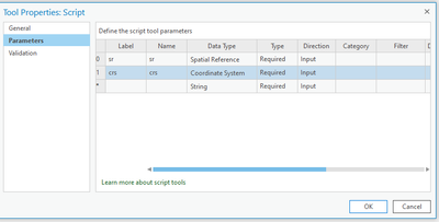

Use the SpatialReference or CoordinateSystem objects directly (i.e. use arcpy.GetParameter instead of GetParameterAsText)
import arcpy
#This works
sr = arcpy.GetParameter(0)
arcpy.env.outputCoordinateSystem = sr
#So does this
crs = arcpy.GetParameter(1)
arcpy.env.outputCoordinateSystem = crs
