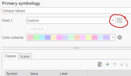

Hello,
What is the best way to access the subject expression using python arcpy.mp module (if possible?)?
Thank you,
Tyler

Thanks @AlfredBaldenweck.  I ended up there and was able to access the unique value symbology expression and make it work.
Cheers,
Tyler
