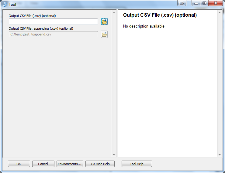

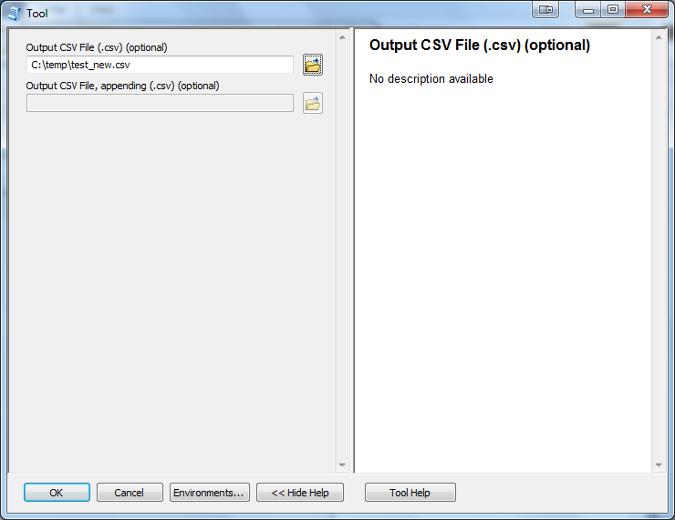

yosukekimura
Here is more or less what I would do...  I am taking method 4 of my original post.
Tool has two boxes, one grayed out (Figure 1).  Usually specify output file name in top box (Figure 2).  If I put a file which has partial but valid data, script moves the file name to bottom clear the top box (Figure 3).  execute() find value for the second box (Parameter in_csv ) instead of the first box (out_csv), and append the data.  If the file provided is not compatible with the tool, tool is going to overwrite the file (Figure 4).  Code at the end.
Figure 1. Intial dialog
Figure 2. New file
Figure 3. Appending to partial file. I set the file name in first box, and the script judge that it is for appending and move it the second box
Figure 4. Overwriting existing file.  In this case the csv file I provided is not what's expected for appending, so tool is going to overwrite.
