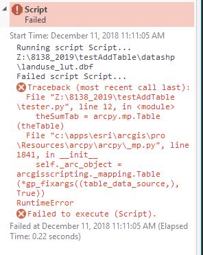

I am trying to add a .dbf table from disk to an existing map in an ArcGIS Pro project. The addTable method of the Map class works with a file geodatabase table, but does not work with a .dbf table. I created a simple map and script tool to test this, and a python script tool with a single input parameter of type "Table"

When I test this script tool by navigating to a .dbf table it fails:

Thanks for replying Dan. I do not want to have to convert the .dbf table to a file geodatabase table, which is what copy rows or table to table does. If the .dbf table has already been added to the map manually, listTables will return it in the list.  I did try your suggestion of the Describe function to look at the table properties. However, that made me realize my script is failing when I use the Table function of arcpy.ma, not the addTable method of the map. So I am not able to use the Table function of arcpy.ma to create a table object from the string holding the table data source  as it outlines in the help ( Table—ArcPy | ArcGIS Desktop ). Perhaps the string that represents the data source of the .dbf table needs to be in a different format - I have encountered issues with coverages and ArcGIS Pro, maybe there are issues with dbf tables associated with shapefiles too.
