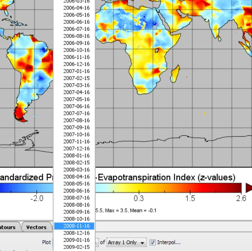

The image showing the format of Year-month-date
