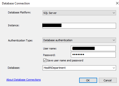

KevinPiraino2
This is the connection properties for the SDE file on the server machine:
