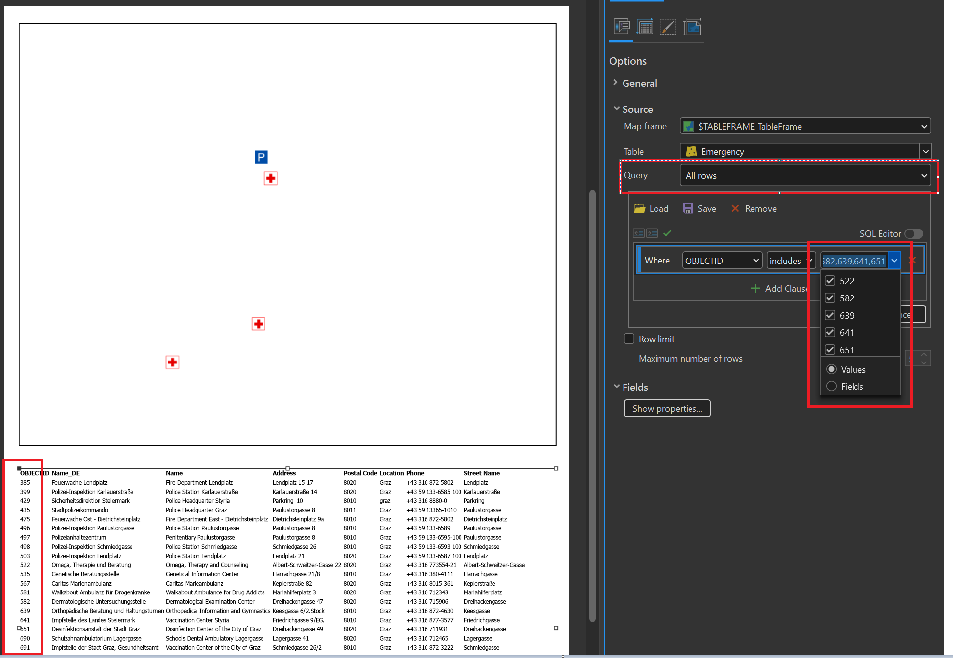

I am preparing an ArcGISProject, a layout and its elements within a python toolbox (.pyt). When the layout contains a TableFrameElement (CIMTableFrame) and the referenced map a selection, I try to apply a CustomWhereClause on the TableFrameElement in order to reflect the map's selection in the table. This works fine when the TableFrameElement.Query is set to VISIBLE_ROWS. However, if the TableFrameElement.Query is set to ALL_ROWS the custom where clause does not seem to apply when exporting the layout and the table just ignores it.
It is quiet good observable when opening the working ArcGISProject. The CustomWhereClause is not applied to the TableFrameElement if Query is set to ALL_ROWS. After clicking around in the project (opening the map, zooming to a layer, reapply the same query, etc.) suddenly the query is applied. So there is an update trigger missing somewhere?

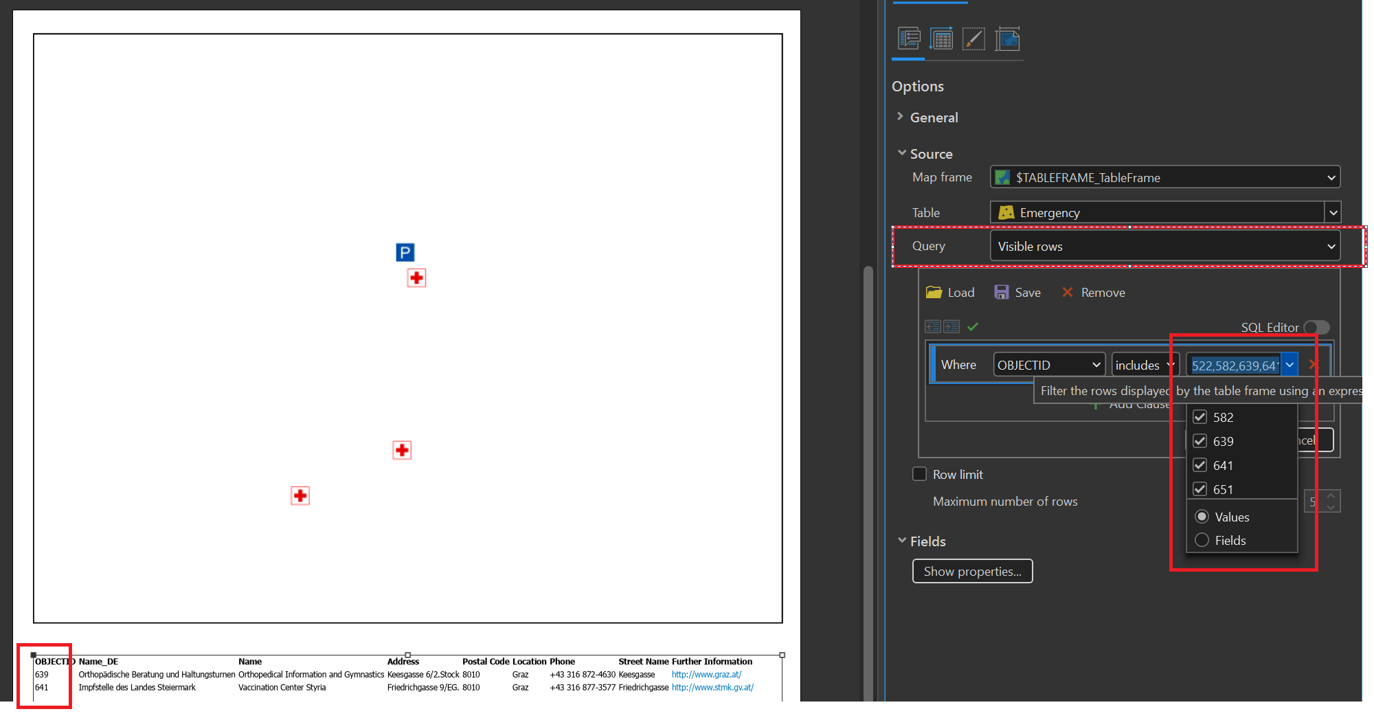

The CustomWhereClause is successfully applied to the TableFrameElement if Query is set to VISIBLE_ROWS.

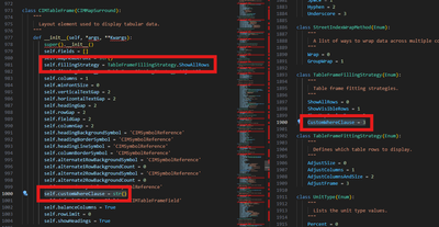

It does seem that CIMTableFrames use ShowAllRows as the default flag for fillingStrategy, but CustomWhereClause is available in the enum:
Have you tried to set the fillingStrategy attribute of the TableFrame to 3/TableFrameFillingStrategy.CustomWhereClause?

I did try this, but applying it with setDefinition(cim) does not seem to have any effect. The doc also implies that the CustomWhereClause fillingStrategy is not yet fully supported on the TableFrameElement.
