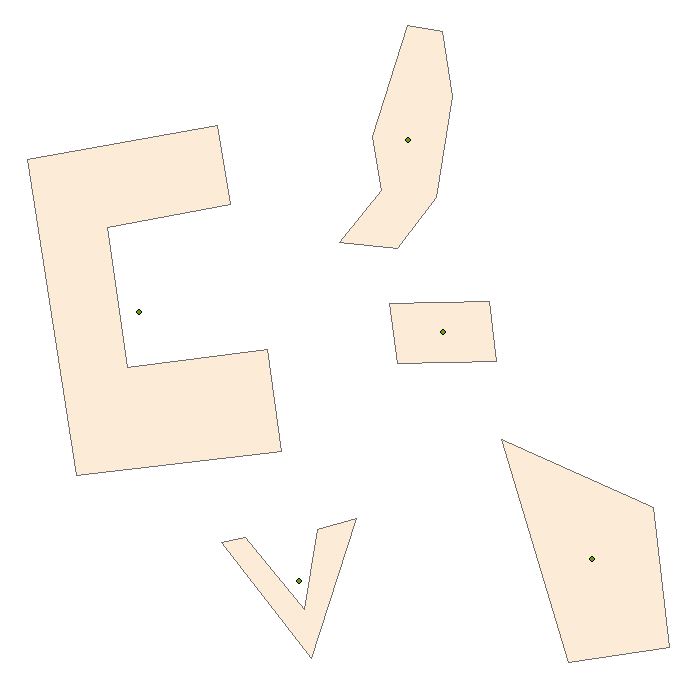

I am attempting to make a script tool that  takes polygon input, and outputs centroid point (within the polygon). This knowledge base article seems to be incorrect, in that the SHAPE@XY token returns the center of gravity for the polygon, not the centroid within the polygon. Likewise, the centroid property in the Polygon class, used in the code below, returns the center of gravity rather than centroid within polygon. Any ideas?

Example output below:

Thanks for the replies, but still "no."
It is my understanding that "centroid" is supposed to return the labelPoint in the event that the first returned point does not fall inside the polygon.

Thanks, Dan, although I'm reading the exact same help files.
...and I get the same result for centroid, trueCentroid, and labelPoint.
I'll admit I am not fully comfortable accessing geomtries with tokens - could this be the source of the issue? I've produced the same result (centroid outside of polygons) with both SHAPE@ and SHAPE@XY.

Thank you! It goes to show that taking a step back can lend some clarity. In the end, I had misdiagnosed my problem, but your example definitely helped.
The problem was in how I was re-writing the geometry. The major difference in my working script (below) and yours is that mine takes along all (an unknown number) of fields and writes them to the new geometry. I had been assigning the row[0].centroid coordinates to the SHAPE@XY token, but it was later overwritten by the shape value coming in with all fields ('*'). At least, I think that's what was going on...
