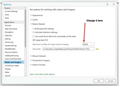

you can change the number of unique values to use with this setting

how many unique values are there in the raster table?

The shp file that I am using to zone with has 238235 elements. The raster file that is to be zonal statistic and find the maximum is a flow accumulation file of Yangtze River Basin made by 30 meter resolution SRTM DEM. Thank you Dan for asking.

Thanks a lot Dan! It works.
