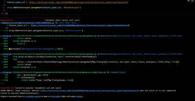

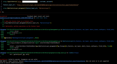

Here's what I see:
Cody
JakeSkinner
Esri Esteemed Contributor
@CodyPatterson try specifying the index number in the Feature Service URL (i.e. /FeatureServer/0).
CodyPatterson
MVP Regular Contributor
Hey @JakeSkinner
I came up with the same error, did yours end up going through?
Cody
