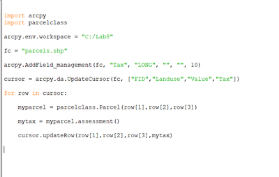

KristenTowsend
Hi , so below is the formatted code pic
when i run the code i get the following error.
myparcel = parcelclass.Parcel(row[1],row[2],row[3])
TypeError: __init__() takes 3 positional arguments but 4 were given
DonMorrison1
You should only pass 2 parameters to the init function - 'self'  is sort of implied, which I find confusing coming from a C++ background. Anyway - here is how I would do it which I think is a bit clearer. It didn't look like you were using the FID field so I got rid of it - and I now see how you calculate the assessment.  Using a class to calculate the assessment seems like overkill, but you must have a reason to use it .....
cursor = arcpy.da.UpdateCursor(fc, ["Landuse","Value", "Tax"])
for land_use, value, tax in cursor:
    myparcel = parcelclass.parcel(land_use, value)
    mytax = myparcel.assessment()
    cursor.updateRow([land_use, value, mytax])
KristenTowsend
thank you! but for some reason, I think the code isn;t working for line 3.
