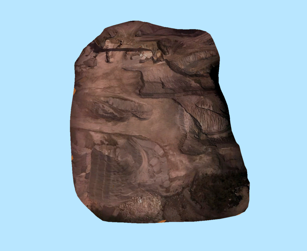

1) Import .OBJ File to ArcGIS Pro
# Import the .OBJ file as Feature Class
arcpy.ddd.Import3DFiles(
    in_files=r"D:\models\gravel\compressed_gravel.obj",
    out_featureClass=r"C:\Users\mwylie\Documents\ArcGIS\Projects\zoom-issues\zoom-issues.gdb\gravel_Import3DFiles",
    root_per_feature="ONE_ROOT_ONE_FEATURE",
    spatial_reference='PROJCS["WGS_1984_Web_Mercator_Auxiliary_Sphere",GEOGCS["GCS_WGS_1984",DATUM["D_WGS_1984",SPHEROID["WGS_1984",6378137.0,298.257223563]],PRIMEM["Greenwich",0.0],UNIT["Degree",0.0174532925199433]],PROJECTION["Mercator_Auxiliary_Sphere"],PARAMETER["False_Easting",0.0],PARAMETER["False_Northing",0.0],PARAMETER["Central_Meridian",0.0],PARAMETER["Standard_Parallel_1",0.0],PARAMETER["Auxiliary_Sphere_Type",0.0],UNIT["Meter",1.0]];-20037700 -30241100 10000;-100000 10000;-100000 10000;0.001;0.001;0.001;IsHighPrecision',
    y_is_up="Z_IS_UP",
    file_suffix="*",
    in_featureClass=None,
    symbol_field=None
The OBJ file successfully loads as a 3D layer in my local scene. Since there's no geospatial data attached to the .OBJ file, it defaults to (0, 0).

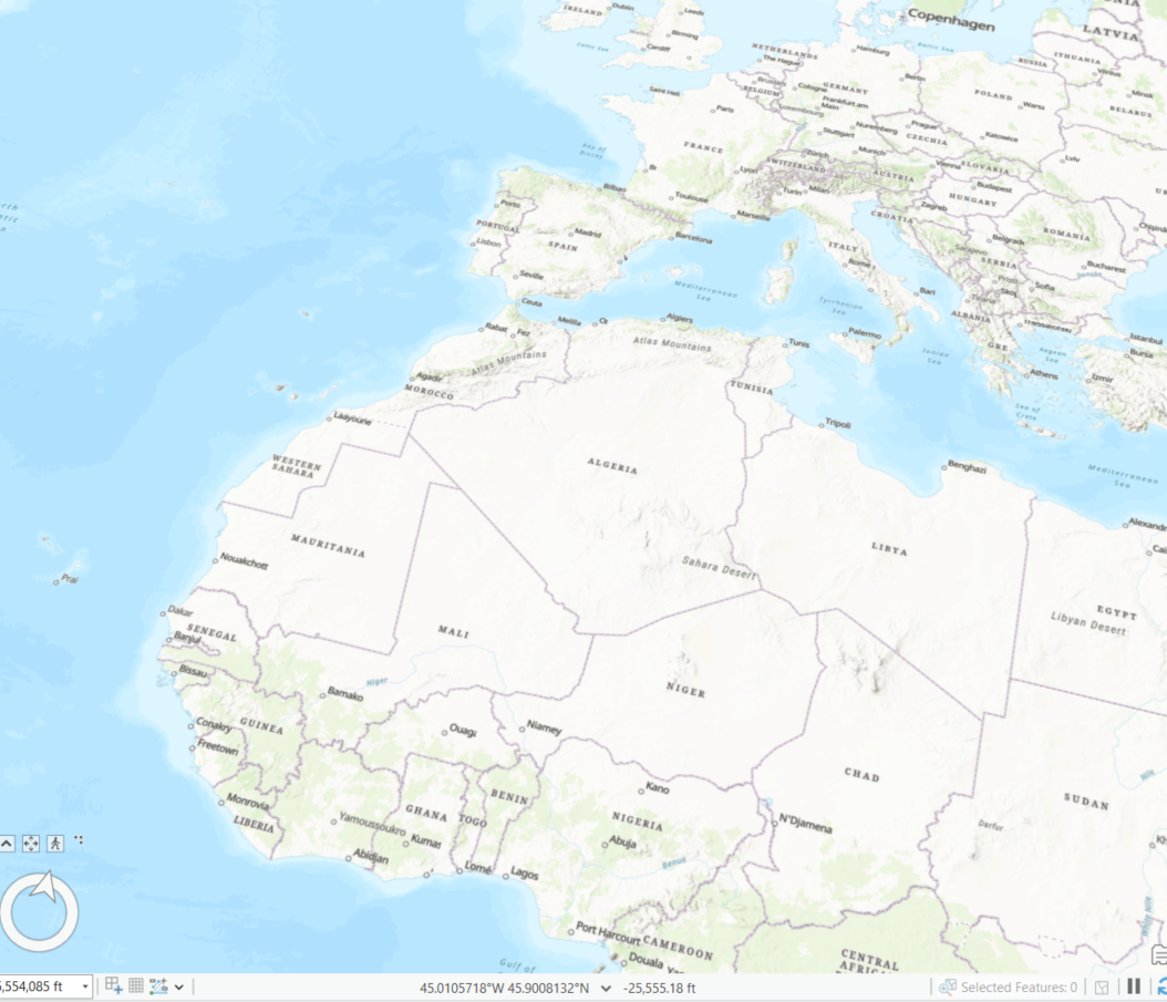

I set the coordinates to (2.344636, 48.855364) [Paris, France] and move the object successfully to that location. The location won't reflect automatically; you'll need to right-click on the gravel_Import3DFiles feature layer -> Properties -> Cache -> Clear Cache, then the object will move. Right-click the feature layer again, then click Zoom To Layer, and you'll get this extreme zoom out. The zoom can be fixed in two ways:
  1. Right-click the gravel_Import3DFiles -> Properties -> Indexes -> Spatial Index -> Recalculate. This will fix the spatial index and correct the zoom. This can't be done programmatically, from what I've researched.
  2. Go to Geoprocessing -> Data Management Tools -> Indexes -> Add Spatial Index. Under Import Features, select gravel_Import3DFiles feature. Click run and it'll fix the spatial index and correct the zoom. This can be achieved programmatically (in theory).

This script is a direct copy from the Add Spatial Index tool (instead of clicking Run, click the dropdown arrow and click Copy Python Command). After running this, right-click the gravel_Import3DFiles layer and select Zoom To Layer and nothing happens. However, if you save the project and re-open the project, the zoom will be corrected.
I've tried recalculating the feature class extent programmatically, toggling the feature visibility, clearing the feature cache, clearing the ArcGIS Pro cache, removing the layer and adding it back in.. essentially trying to replicate closing ArcGIS Pro without closing it. It doesn't make sense that the Geoprocessing tool version of Add Spatial Index works, but when using in the Python Notebook, it doesn't work.
