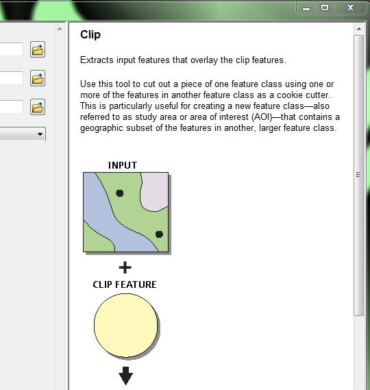

I am adding a python toolbox help using "Item Description...".
I would like to add some photos to my description same as the following for Clip tool:
But there is no way to add a photo like above.

a-quick-tour-of-documenting-tools-and-toolboxes  then
  • Tool sidebar help image: This is an image that appears in the side-panel help for the tool. It is recommended that the width of the graphic not exceed 400 pixels.
