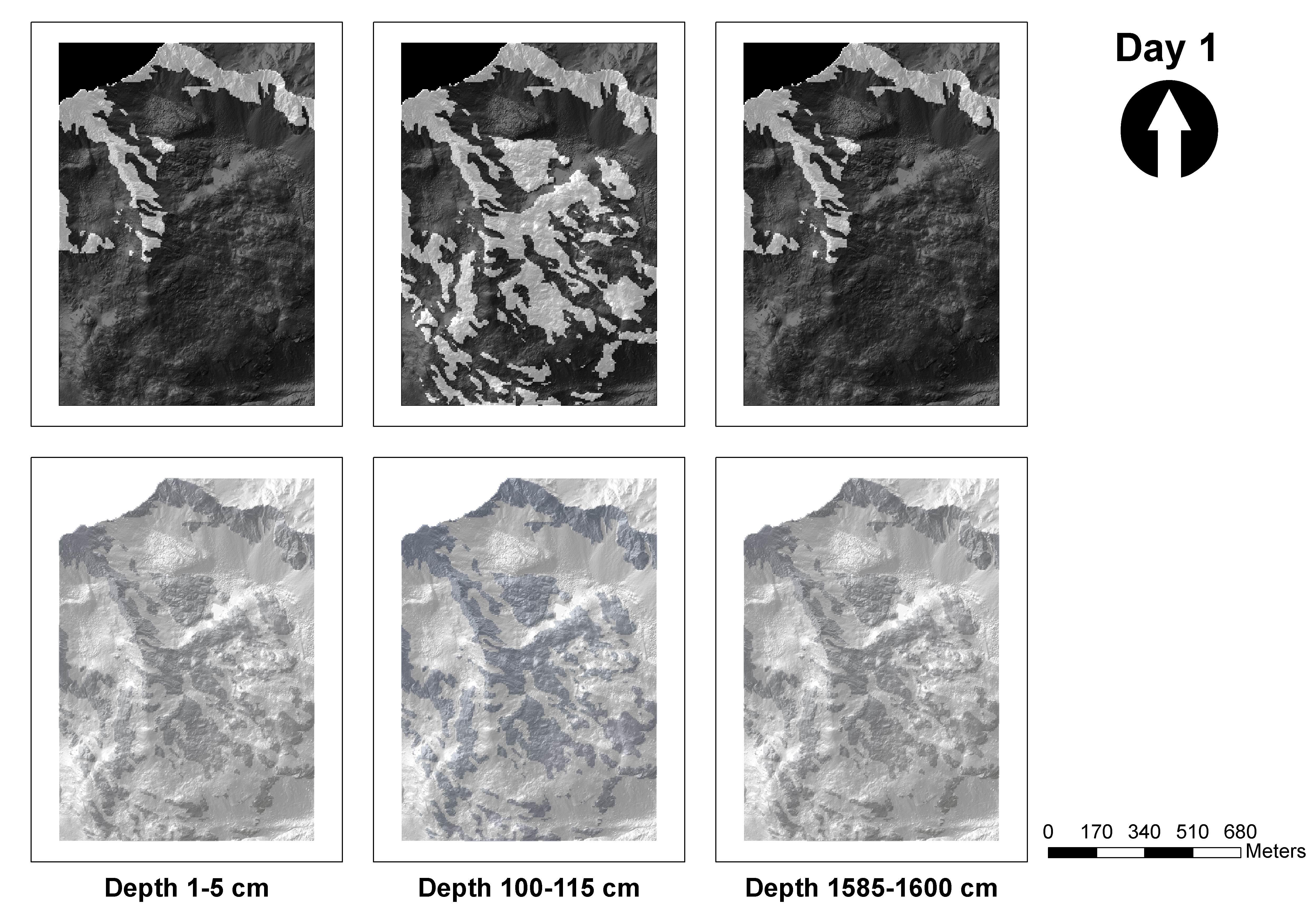

I am doing my first steps in arcpy.mapping: I am trying to export a map as jpeg 365 times and exchange the data for each day of the year in six dataframes within the layout accordingly. I have two issues I just cannot get solved and would really appreciate any help:
1. I am creating a .clr file from scratch (lines 10-17)  to use in arcpy.AddColormap_management (line 44). However, the cells that should be blue are diplayed transparent and the ones that should be transparent are black (see upper row of first screenshot). It worked with a single dataframe but with more not anymore (although I am not sure if the df number is the problem). How can I solve this?

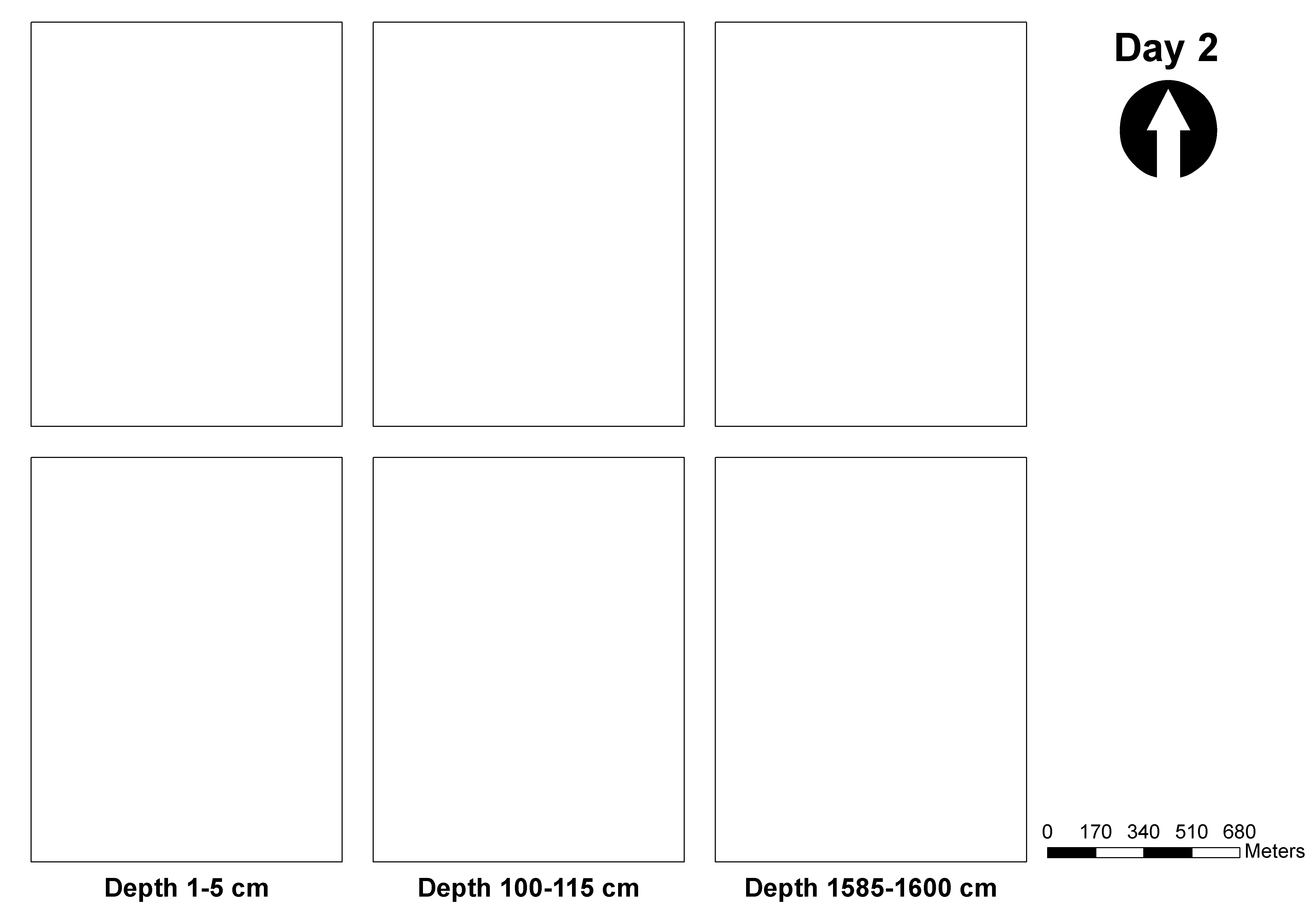

2. Most important: Only the first map I export does contain data. All other 364 ones only display empty dataframes. This is why I thought that sth is wrong with the loop over days, but the Text (line 97) is changed as I wish (see second example). I have now idea why all the other datasets are not found.
I have attached two examples of the first two maps exported to show what I mean,

Finally managed to correct this myself:
1. Instead of a clr file I used arcpy.ApplySymbologyFromLayer_management and prepared a model layer file in the gui.
2. Line 27 needs  to go inside the day loop.
