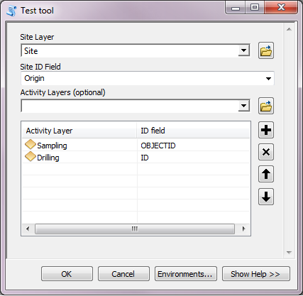

I want a python script tool that has a value table with drop down choices. In this example I want to add multiple layers and select different fields as different datasets have different names for their ID fields. The interface I have created looks as below.
When you add a new activity layer the ID field becomes a drop down for that row, listing fields from the dataset.

Limitations
The main limitation is that the logic of the script searches for the last row, reads the layer name and then sets the filter to be the fields of that dataset (just what you want). If you have added more than 2 layers and then go back to say the first row to choose another ID field you discover that the filter applies to the whole column and not the individual row so you will get fields offered up from the last layer in the valuetable.
I have been unable to work out how you can set drop downs specific to a row. There is no way that I have found that captures the onclick event of a cell in a valuetable. If you are an esri python guru (may be part of the development team?) reading this I would love to know if this can be done? Just look at the Create TIN tool to observe the technique I am looking for.
