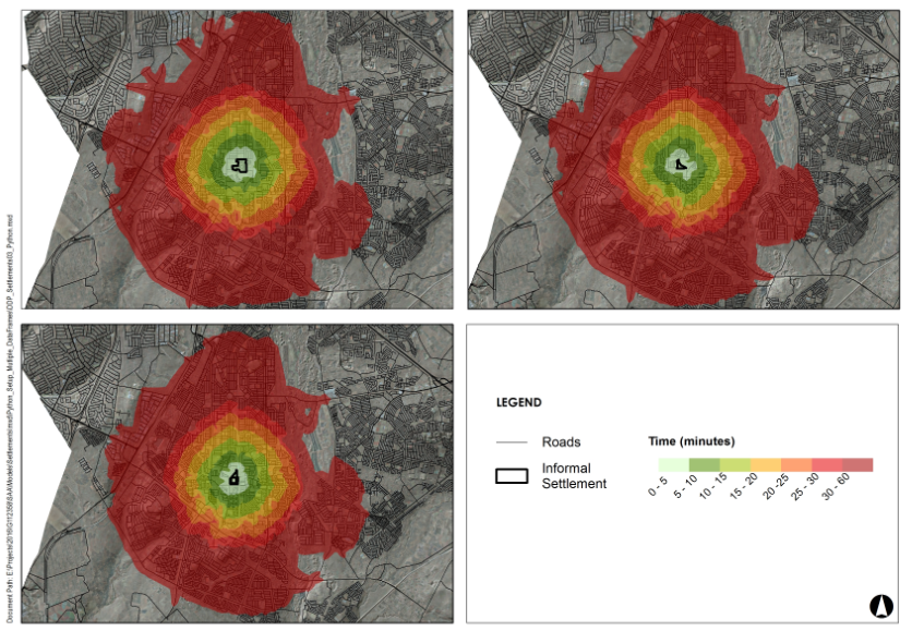

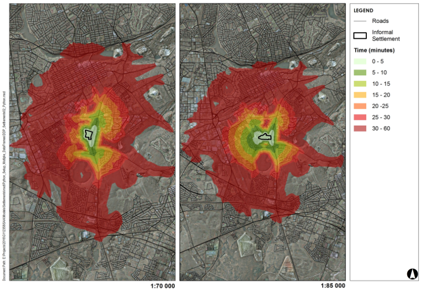

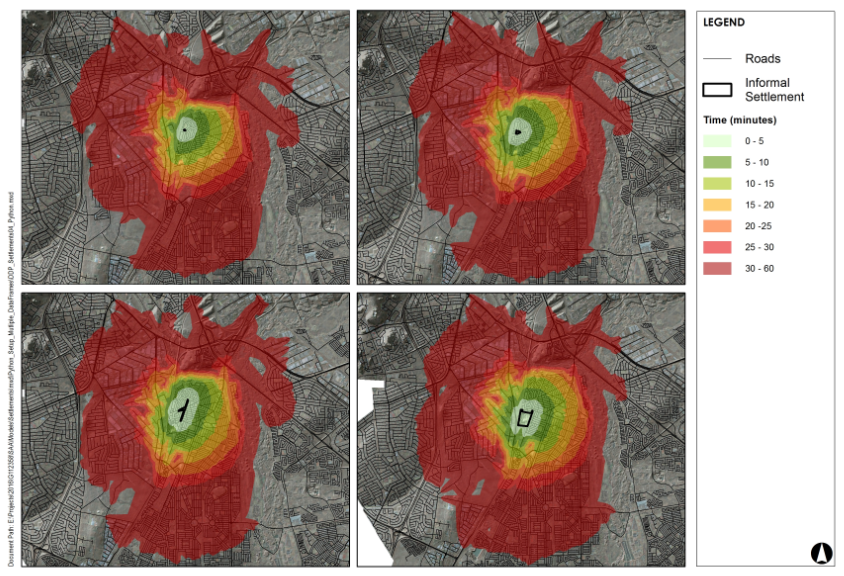

I needed to create a ArcMap Document with Multiple Data Driven Data Frames. I realised that Data Driven Pages wouldn't allow me to accomplish the following as well as I needed it to handle any number of Data Frames without having to rewrite my Python Function. I have accomplished the following by creating a list of unique features based on my index layer that one would use if using Data Driven Pages. I then loop through each Data Frame, three layers within each Data Frame that needs to be updated based on the index layer. I then apply a definition query to each of the layers to create the view that I'm looking for for each index. I then obtain the extent of each index and set the Data Frames extent to the indexes extent as well as adjusted the Data Frames scale to the nearest 5000, which can be adjusted as needed. I've attached print screens of the ArcMap Documents with: X2 Data Frames ; X3 Data Frames ; X4 Data Frames as well as the code.

Dynamic Data Frames X2
Dynamic Data Frames X3
Dynamic Data Frames X4
