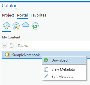

    • Make sure you are signed into a portal. From the Catalog pane in ArcGIS Pro, go to Portal > My Content, right-click a notebook item, and select Download.

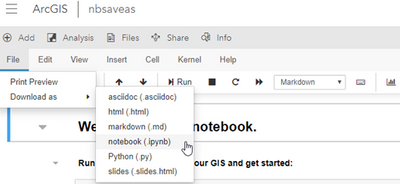

    • Signed into Portal on the web browser. From the Notebook Editor in Portal, on notebook menu ribbon, click File> Download as > notebook ( .ipynb ).

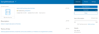

    • Signed into Portal on the web browser. From the notebook's Item Details page (accessible from the Content tab by clicking on a notebook item), click Download to download the notebook in .ipynb format.

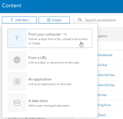

    • You can upload any notebook file (.ipynb) to your portal. Sign into your organization's Portal from the browser, go to the Content tab of the contents page, click Add Item > From your computer and choose From my computer. From the Add an item from my computer dialog, click Choose File and browse to a notebook file on your computer, provide a title and tags, and then click Add Item.

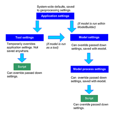

Q: Why are the environment variables I set in Notebooks (or Python Window) not being honored by Geoprocessing tools I run from the Geoprocessing pane?
A: This behavior is due to the environment levels hierarchy.
When setting an environment variable using arcpy.env, you are setting it at the Script level. Since this is the lowest level in the hierarchy, the setting will not be honored at any of the above levels. In order for your environment variables to be honored by both Script and Geoprocessing tools, you must set the environment variables using the Application settings from your project.
